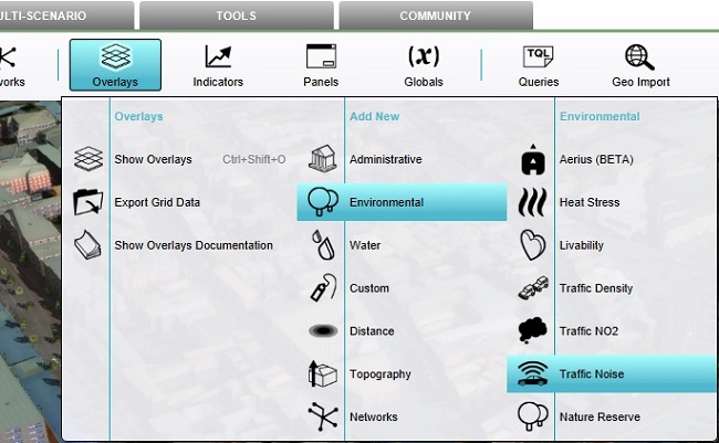

Add a Traffic Noise Overlay.
Editor → Current Situation (Ribbon tab) → Overlays (Ribbon bar) → Environmental (Dropdown) → Traffic Noise
Adding the Traffic Noise Overlay from the ribbon.

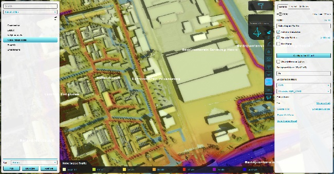

This Traffic Noise Overlay will serve as the primary input to work with. It computes results based on built-in formulas for noise from traffic. Although it's possible to tweak the inputs and the legend of the resulting Overlay, the principles of the calculation and the results thereof are immutable.
The traffic noise overlay is a standard calculation model.

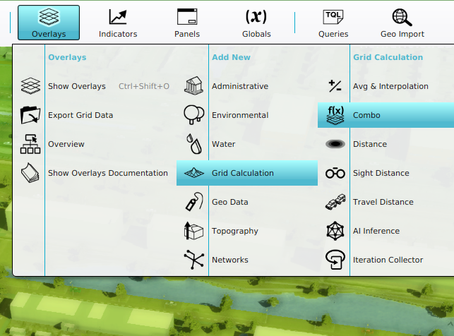

Add a Combo Overlay.
Editor → Current Situation (Ribbon tab) → Overlays (Ribbon bar) → Custom (Dropdown) → Combo
Adding the Combo Overlay from the ribbon.

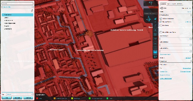

The Combo Overlay will, by itself, not show any significantly relevant results. This is because no inputs have yet been set, nor has a relevant formula been entered.
The default results of the Combo Overlay are uniform and irrelevant.

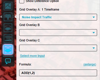

The Combo Overlay accepts a set of inputs, which are Grid Overlays.
Set Grid Overlay A to the added Traffic Noise Overlay.
Set the input A to the Traffic Noise Overlay.

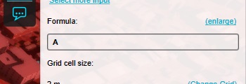

Next, set the formula to:
A
This formula will directly output A.

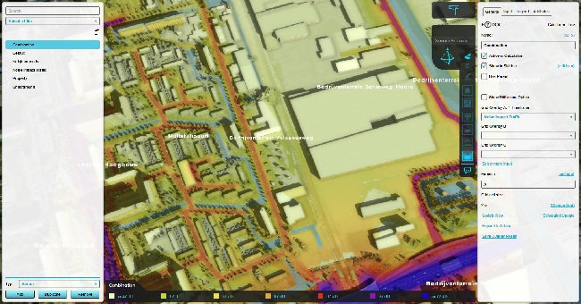

Then, click on ""Update now" to recalculate the Overlays.
The result is that for each grid cell, the value of the input Overlay A, which is set to the Traffic Noise Overlay, is used directly as the result.
Notice that the legend of the Traffic Noise Overlay is directly applied as well. This is because the legend of the first input is automatically read out by the Combo Overlay as the default legend for the Combo Overlay itself.
The results of the Combo Overlay directly outputting the results of the Traffic Noise Overlay.

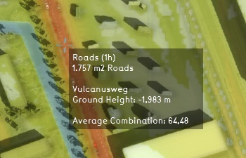

Just like with the Traffic Noise Overlay itself, it is possible to click on any location in the 3D Visualization and see the exact value calculated there.
The hover panel will display the name of the Combo Overlay, and the value of that location.

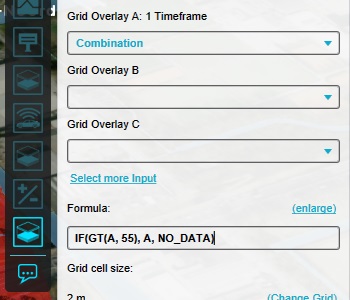

Modify the formula of the combo Overlay, so that it reads as follows:
IF(GT(A, 55), A, NO_DATA)
This formula will remove values lower than 55 from the results.
The formula now contains two logical operations, as well as a NO_DATA constant. The formula can be read as follows:
If ( IF ) it is true that A is greater than 55 ( GT ), in that case we use the value A. Otherwise, we return the value of NO_DATA, which is a constant meaning no value exists at that point.
Click on "Update now" to recalculate the Overlays.
The results of the Combo Overlay have now changed. Only in the places where the Traffic Noise Overlay computed a noise level of more than 55dB have results now been retained. In all other locations, the results have been discarded.

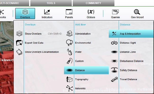

Add an Average Overlay.
Editor → Current Situation (Ribbon tab) → Overlays (Ribbon bar) → Distance (Left panel) → Avg & Interpolation
Adding an Average Overlay from the ribbon.

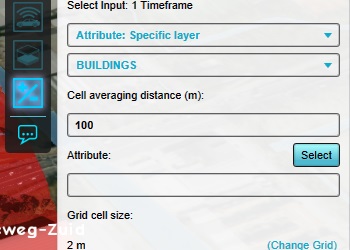

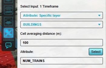

Set the "Input" to "Attribute: Specific Layer", and the layer to "BUILDINGS". This will ensure the Average Overlay is specifically geared towards consululting data from Buildings.
The Average Overlay will only consult the Buildings in the Project.
Next, set the "Attribute" to "NUM_TRAINS". NUM_TRAINS is the Attribute signifying the number of trains which travel across any given Building, such as train tracks.
The Average Overlay will refer to the NUM_TRAINS Attribute.
The "Cell averaging distance", which is set to 100m by default, can be left as-is.
Finally, click on "Update now" to have the Average Overlay recalculate.

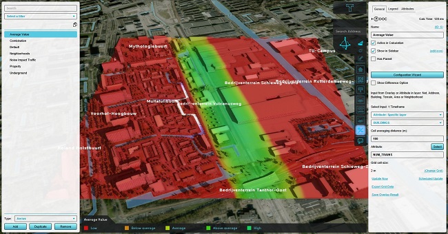

The result will be an Overlay which highlights train tracks, with a radius of 100m. Or in terms more practical for this setup: for any given grid cell, the Average Overlay indicates whether a train track is within 100m.
The results of the Average Overlay when configured.
Any cell with a value of 0 only has cells in a 100m radius with 0's. If any cell within that radius would feature a train track, the computed (average) value would be slightly more than 0. This value in and of itself is not significant or useful, but can serve as a filter to know which cells are "near a train track".

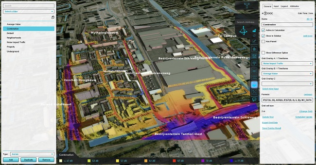

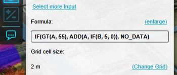

Modify the formula of the Combo Overlay, so that it reads as follows:
IF(GT(A, 55), ADD(A, IF(GT(B, 0), 5, 0)), NO_DATA)
This formula will increase the result, based on another input's value.
Instead of simply resuling in the value of A, instead the calculation will result in the combined values of A and either 5 or 0, depending on whether B has a value greater than 0. Since B will have a value slightly more than 0 when near a train track, this formula will now add an additional 5dB to the total result when near a train track.

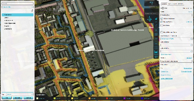

The results are now subtly different, in that for all locations within 100m of the train tracks the noise level is computed as 5dB louder than otherwise.
The results when adding train noise to the masked results.

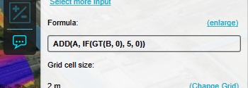

Modify the Combo Overlays formula to read as follows:
This formula will only add the values together (conditionally), and not mask the results anymore.

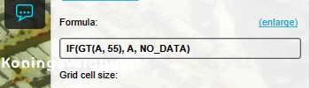

For the formula, ensure that it reads as follows:
This formula once again only displays the results if they are greater than 55.

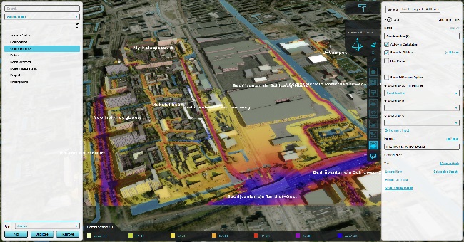

Recalculate, and see the results.
the results of first combining the noise, and then dropping results which are too low.

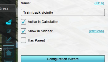

Rename the Average Overlay, highlighting the train tracks, to "Train track vicinity".
Renamed Overlay for the vicinity of train tracks.

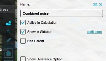

Rename the first Combo Overlay to "Combined Noise".
Renamed Overlay for combined noise.

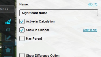

Rename the second Combo Overlay to "Significant Noise".
Renamed Overlay for noise if the noise is significant.

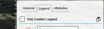

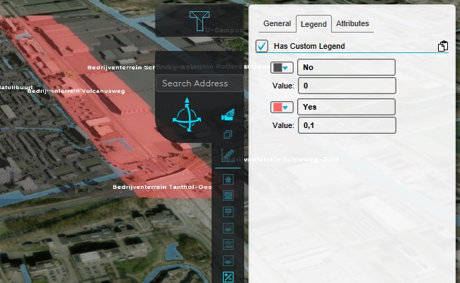

Select the "Train Track vicinity" Overlay (the created Average Overlay), and in the right panel switch to the "Legend" tab.
The "Legend" tab.

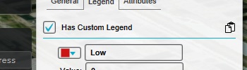

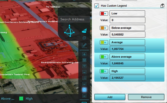

Ensure "Has Custom Legend" is checked. This allows setting which values resulting from the Overlay's calculation conform to which results. Modifying these values allow for creating a clearer or more relevant visualization of the data.
The option for a Custom Legend
Select 3 of the entries, and remove them.
Select the entries, then click remove at the bottom of the right panel.

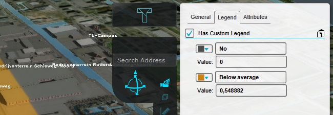

Change the first entry's color to a dark-grey or black, set the name to "No", and ensure the value is 0.
Notice this immediately changes the visualization as well. Although the results of the calculation have not changed, and in fact no new calculation was performed, the way the results are shown are dynamically updated.
The changed entry, and the partially changed visualization to match.
Change the second entry's color to light-red, set the name to "Yes", and ensure the value is set to around 0,1 .
The changed entry, and the fully changed visualization to match.
Notice the Overlay now does not show a progressive coloring, but more of a hard-line yes-or-no indication of what is or isn't near the tracks. This is both the only relevant information that can reasonably be read out of the Overlay, and also the way the information is used by the Combo Overlay. This makes the Overlay clearer and more useful to the user who eventually inspects and uses the Overlay or the Project it is part of.
