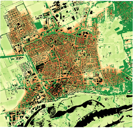

  • PET daytime map for August 2, 2013 12 UTC with the meteorology of the reference station Herwijnen from the DPRA Heat stress report
  • PET daytime map for August 2, 2013 12 UTC with the weather data from the reference station Herwijnen as calculated by the Tygron Platform

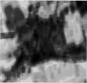

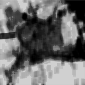

The calculated wind speed differs on areas with large amount of trees, as you can see the images below (Tygron wind map is on the right):
  • Wind speed August 2, 2013 12 UTC
  • Wind speed August 2, 2013 12 UTC as calculated by the Tygron Platform
The foliage input data might be a cause for these differences. See the next section for a possible explanation and possible improvements.
