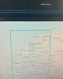

  • A Project must be created as a Basic Mode Project when created. It is not possible to change whether a Project is or isn't a Basic Mode Project later on.
  • A Basic Mode Project will still be counted as license usage, but only for 1/25 the usual size. A Basic Mode Project of 50km² will count for 2km².
  • The maximum size of a Basic Mode depends on both your license and the hardware used. If you can normally create 30x30 km projects, you can create a 180x180km project in Basic Mode.
