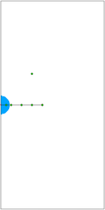

This test is designed to simulate the rate of flood wave propagation over a 1,000 x 2,000 m floodplain following a defense failure (Fig. (a)). The floodplain surface is horizontal, at datum (= 0 m). One inflow boundary condition will be used, simulating the failure of an embankment by breaching or overtopping, with a peak flow of 20 m3/s and time base of ~6 h. The boundary condition is applied along a 20-m line in the middle of the western side of the floodplain.[1]
Figure (a): Modeled domain and the locations of the 20-m line of inflow, 6 output points, and the aimed for 0.1-m and 0.2-m contour lines at t = 1 h (dashed) and t = 3 h (solid), respectively.

Figure 1. The relative positions of the measurement points used in this test.
  • Flat surface
  • Grid-cell size (m): 5
  • Area size (m): 1,010 x 2,010 (required domain of 1,000 x 2,000 + 5-m border)
  • The measurement points were positioned correctly (see Fig. 1)

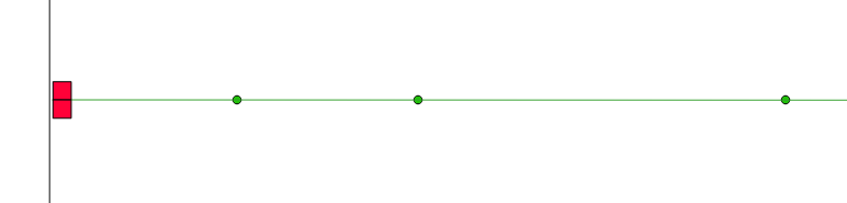

In order to regulate the boundary discharge according the hydrograph (Fig. 2), 2 inlets were implemented. Both inlets occupied one grid cell, one of these located above and the other below the green center line (Fig. 3). The inlets were configured as follows:
  • External area (m2): 1,000,000,000 (default)
  • Water level (m): 1 (default)
  • Threshold (m): none (default)
  • Inlet Q (m):
Figure 2. Hydrograph displaying the implemented individual and combined inlet fluxes.
Figure 3. Positions of the inlet cells (red squares) with respect to the center line of measurement (green).

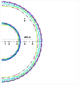

Contours of inundation extent (>= 0.15 m depth)

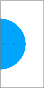

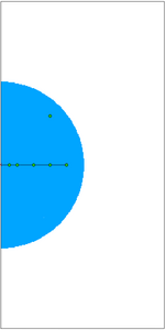

  • t = 30 min
  • t = 1 h
  • t = 2 h
  • t = 3 h
  • t = 4 h

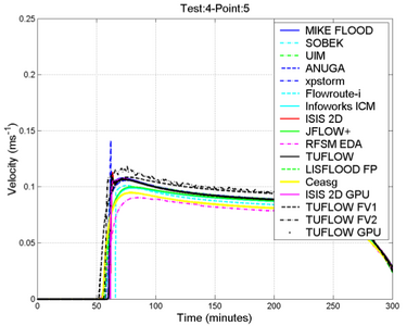

  • Results of other packages for t = 1 h and 3 h.

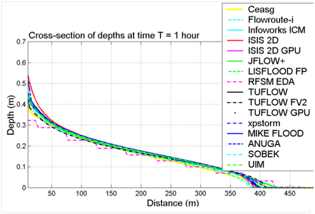

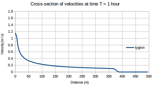

  • Water level across center line at t = 1 h.
  • Water level across center line at t = 1 h for other packages.

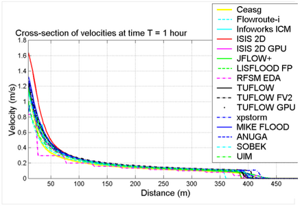

  • Flow velocity across center line at t = 1 h.
  • Flow velocity across center line at t = 1 h for other packages.
Time series of water level and flow velocity

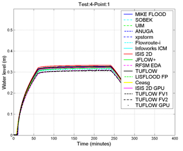

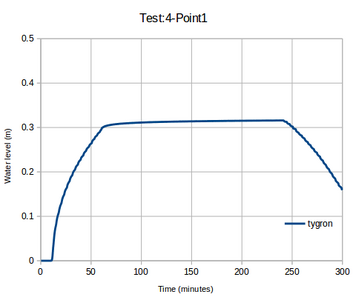

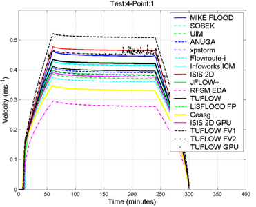

  • Water level at Point 1.
  • Water level at Point 1 (others).

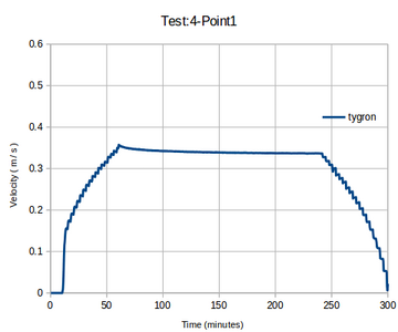

  • Flow velocity at Point 1.
  • Flow velocity at Point 1 (others).

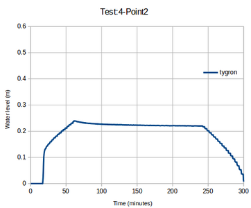

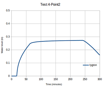

  • Water level at Point 2.

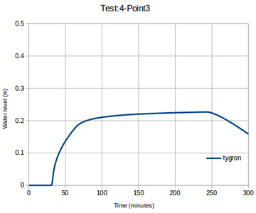

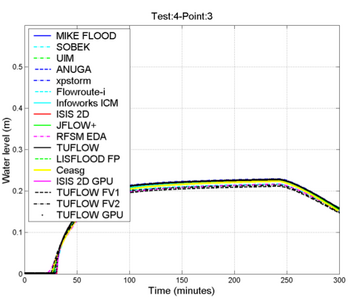

  • Water level at Point 3.
  • Water level at Point 3 (others).

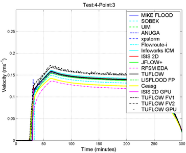

  • Flow velocity at Point 3.
  • Flow velocity at Point 3 (others).

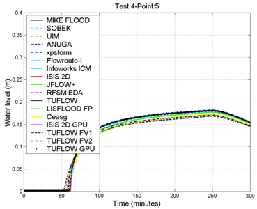

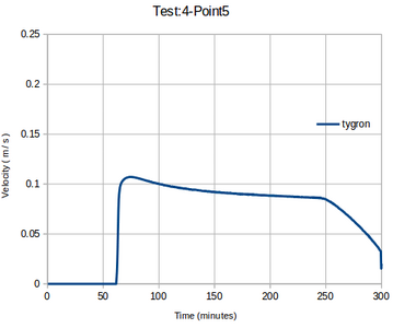

  • Water level at Point 5.
  • Water level at Point 5 (others).
  • Flow velocity at Point 5.
  • Flow velocity at Point 5 (others).

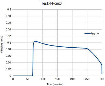

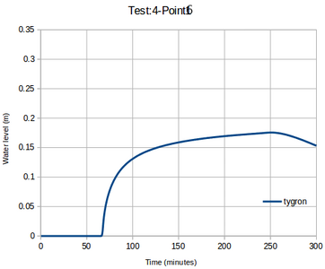

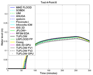

  • Water level at Point 6.
  • Water level at Point 6 (others).

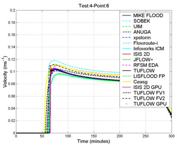

  • Flow velocity at Point 6.
  • Flow velocity at Point 6 (others).
  • Test results of Point 2 and 4 for the other packages were not provided.
  • The stepwise behavior seen in the velocity profiles can be related to the definition of the inlet inflow, which is also stepwise.
