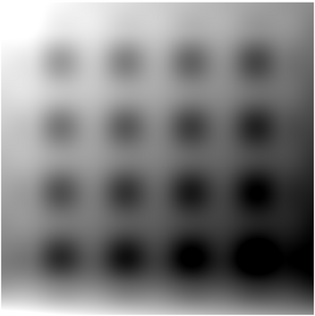

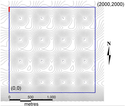

Fig. (a): Map of the DEM showing the location of the upstream boundary condition (red line), ground elevation contour lines every 0.05 m and output point locations (crosses).
The area modelled, shown in Fig. (a), is a perfect 2,000 m x 2,000 m square and consists of a 4 x 4 matrix of ~0.5-m deep depressions with smooth topographic transitions. The DEM (digital elevation model) was obtained by multiplying sinusoids in the north to south and west to east directions, and the resulting depressions are all identical in shape. An underlying average slope of 1:1,500 exists in the north to south direction, and of 1:3,000 in the west to east direction, with a ~2-m drop in elevation along the north-west to south-east diagonal.[1]

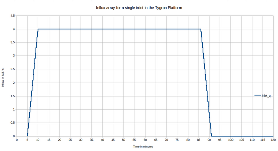

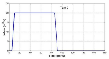

The inflow boundary condition was applied along a 100-m line running south from the northwestern corner of the modelled domain, indicated by a red line in Fig. (a). A flooding with a peak flow of 20 m3/s and time base of ~85 minutes was implemented according the hydrograph in Fig. (b). The model was run for 2 days (48 hours) to allow the inundation to settle to its final state.[1]
Fig. (b): Inflow hydrograph, which functioned as upstream boundary condition

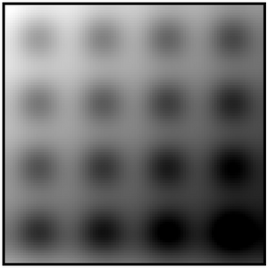

  • Original 2-m heightmap (2,400 m x 2,400 m)
  • Cropped and rescaled to 20-m grid (2,040 m x 2,040 m). The black perimeter designates the border cells.

In order to regulate the water level according to the water-level graph, the following setup was used: Inlet objects were placed on single grid cells with a constant value for x = 1 and y varying from 1 to 5, yielding a total of 5 points. The inlets were configured as follows:
  • External area (m2): 1,000,000,000 (default)
  • Water level (m): 1 (default)
  • Threshold (m): none (default)
  • Inlet Q (m3/s) : 20 in total, thus 4 per inlet
Hydrograph for each individual inlet.

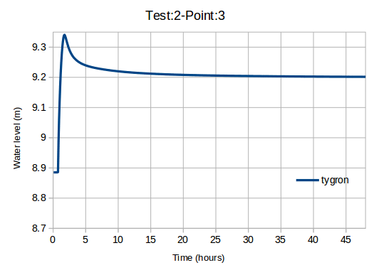

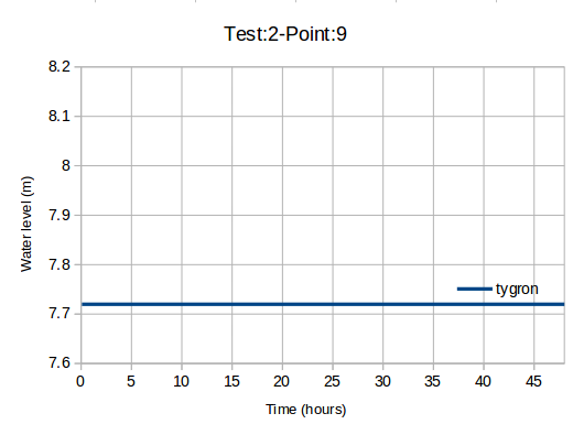

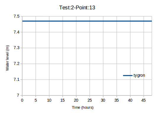

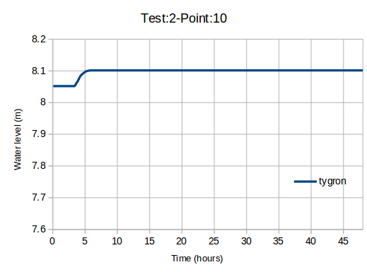

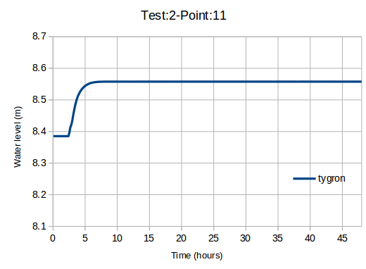

Test results

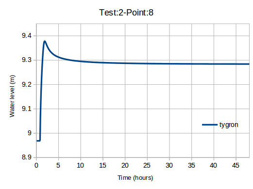

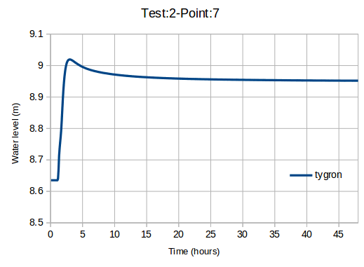

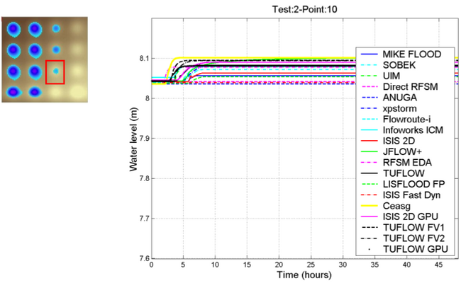

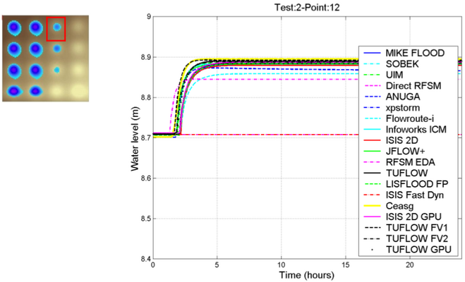

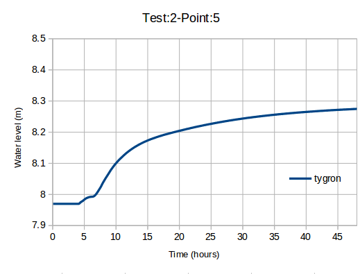

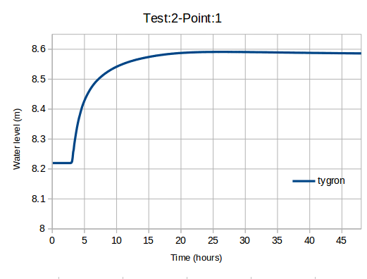

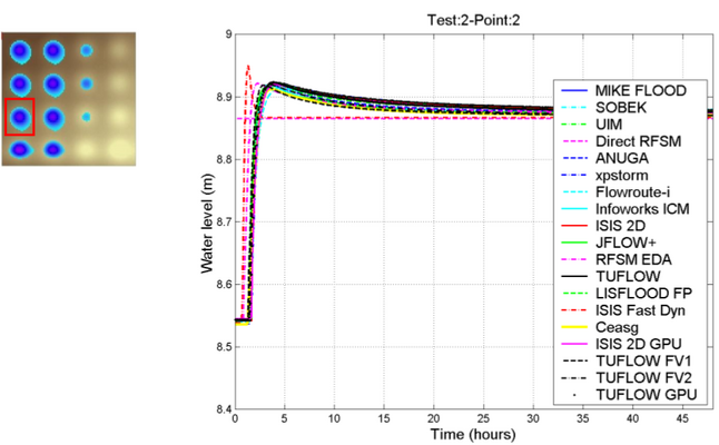

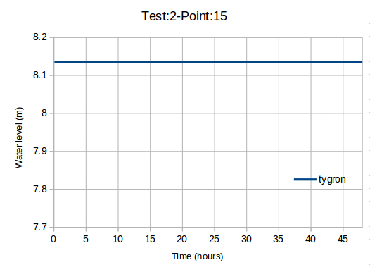

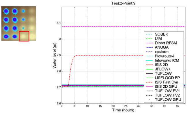

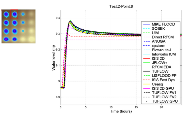

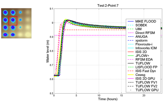

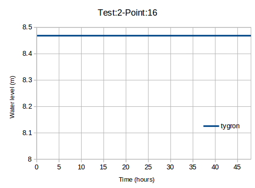

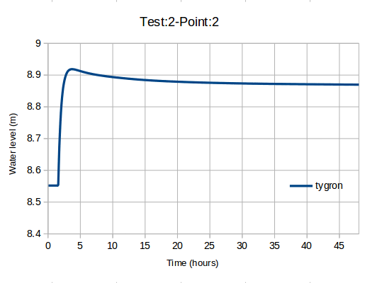

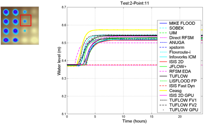

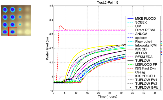

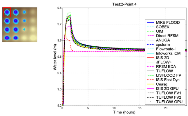

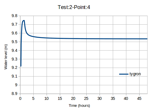

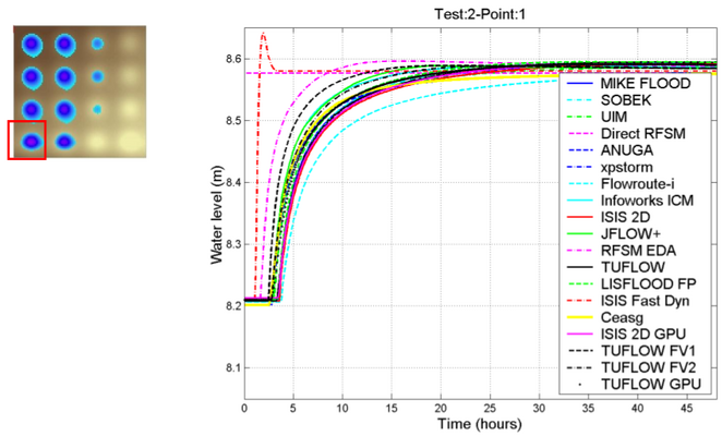

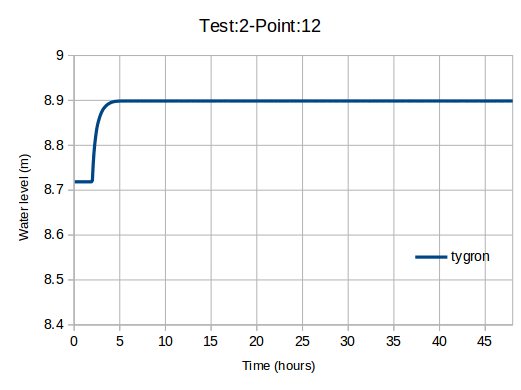

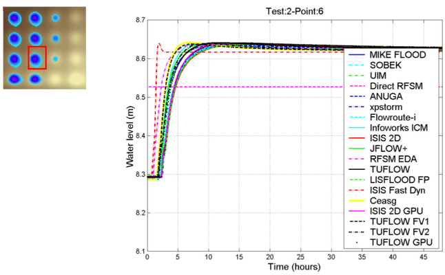

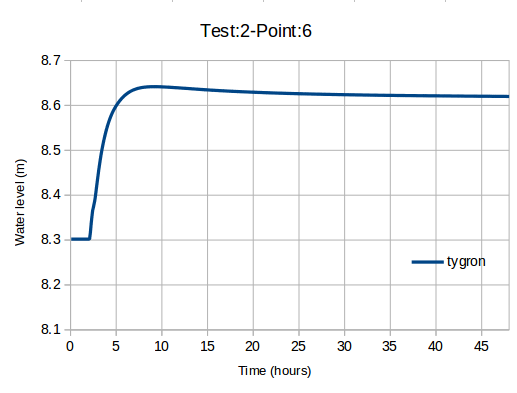

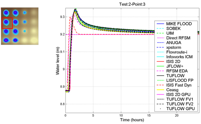

Point graph measurements from the Tygron Platform (left) and other packages (right):
Last frame

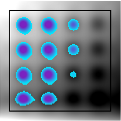

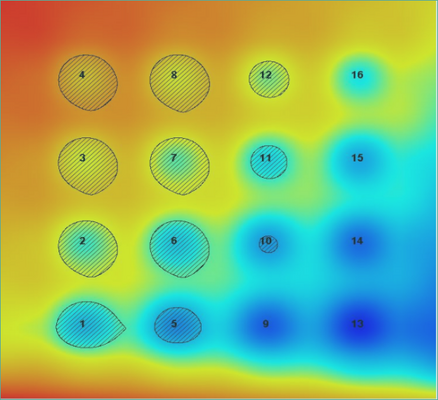

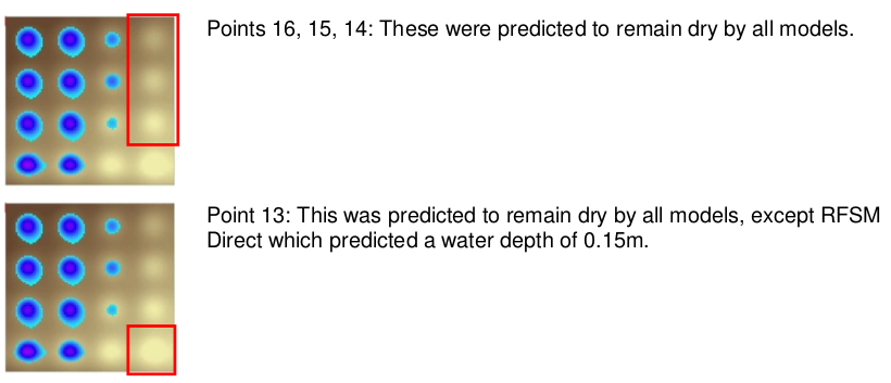

  • Final timeframe of water levels as generated by the Tygron Platform (left) and by the other packages (right).
  • Tests were run with a multi-GPU setup. For small cases like this, using single GPU actually leads to faster results. Furthermore, requesting a high number of 576 timeframes further bogs it down. In comparison: 1 GPU with 1 resulting timeframe runs in: 8 s, which is +- 53% faster compared to 2 GPUs with 576 timeframes.

Water level relative to datum
The time series of a fixed measurement point can be obtained as follows:
How to obtain water levels relative to datum:
  1. Go to the flooding overlay "Water Level (m)".
  2. Select the measuring tool.
  3. From the Saved dropdown choose your point of interest.
  4. From the Base dropdown select "Surface Elevation (m)".
  5. Make sure the Sum box is checked.
  6. Select Fit Graph to zoom in on the relevant part of the plot.
