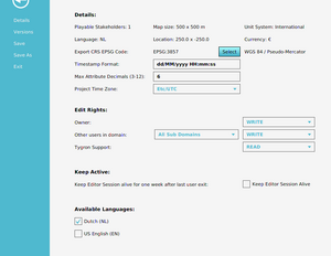

The Timestamp format used in your project can be changed in in the Project Detail panel. This format will be used to interpret timestamps present in time-values CSV data, used for example by an Inlet Q's dynamic range in the Water Overlay Wizard.

Here the letters indicate the way the numbers are automatically interpreted by the Date parser used in the Tygron Platform. It is important that when you start importing CSV data with timestamps, you should first check what Timestamp formats are in the file and adjust the project's timestamp format to that format.
When you don't configure it correctly, you might receive errors of unrecognized timestamp formats, or worse, import the dates wrongly without any notice.
