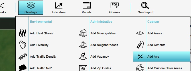

Start by adding the overlay we're going to test. Add an average overlay to the project.
Add an average overlay.

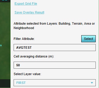

Prepare the overlay in such a way that it will calculate the spatial average of a user-defined attribute. As Filter Attribute, enter "AVGTEST" in the General tab in the right panel. Also set the Cell averaging distance to 50m. This will ensure that multiple entities can be drawn in the map and be spatially calculated, without necessarily affecting each other's outcomes.
Configure the average overlay to calculate using a user-defined attribute, and a relatively small radius.

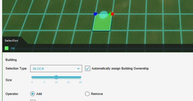

Now add a construction to the project, and place it more or less in the center of the project. Make sure you use the block-based brush, and draw in exactly 1 block (10m by 10m, for a total of 100m²).
Draw a construction, with the size of a single 10m by 10m block.

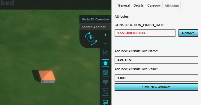

Add an AVGTEST attribute to the construction, with a value of 1000.
Assign an AVGTEST attribute with value 1000 to the construction.

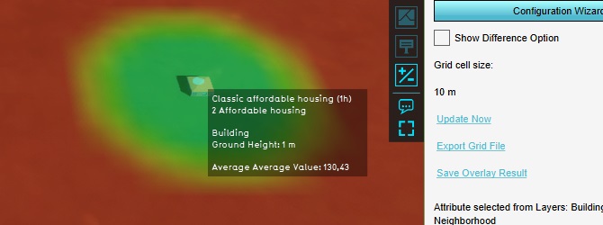

Switch back to the average overlay in the editor, and select "Update Now" to recalculate the content

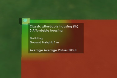

Now, if you open the average overlay, you will see the construction is the center of a large area where the average value of AVGTEST is higher than in all other locations in the project area.
The average value at the location of the construction is around 130.
This setup creates a first look into how the average overlay functions. In the exact location of the construction, and its direct surroundings, the average value of AVGTEST is around 130. It tapers of at a distance of about 50 meters.
Note that you may see a value lower than 130, based on the exact location you have placed the construction. This is due to the construction's alignment on the calculation grid. This is expected, and does not affect the principles explained next. Take note of the value you see in your project, and continue.

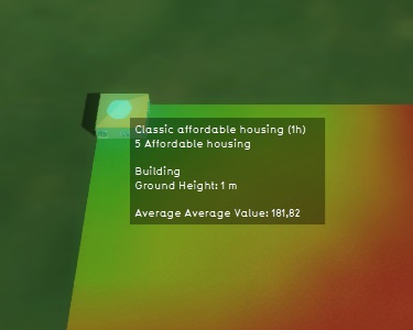

We can now add another construction to the project, again with an AVGTEST attribute set to a value of 1000, and place that construction in the corner of the project area. Again, making sure that the construction is exactly 1 block of 10m by 10m, for a total of 100m².
Recalculating the overlay and looking at the average value at the location of the new construction gives an average value of 180.
The average value at the location of the construction is around 180.
The fact that the calculated value in the corner is higher indicates that the cells outside the project area don't have an assumed value of 0 or lower.

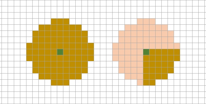

Note that based on the conclusion we have drawn, you may be tempted to expect the calculated values to match more neatly. Specifically, if the construction in the middle of the map has a full circle around it in which to perform its calculation, the construction in the edge of the map must have a quarter of the area of similar circle, thus the values should differ by a factor of 4. However, due to the layout of the constructions on the grid this is not the case.
Schematic functioning of the grid for spatial averaging calculations. Left: the circle taken into consideration given a specific cell in the middle of the map. Right: the section of the circle taken into consideration when the specific cell is at the corner of the map. Notice the area of the section on the right is not an exact quarter of the section on the left.
Also note that based on the exact size, placement, and rounding of values and polygons, it may be difficult to derive the outcomes seen from the base values without greater insight into the exact interpretations the Tygron Platform makes. This is to be expected, and the approach used here functions regardless of those exact calculations.

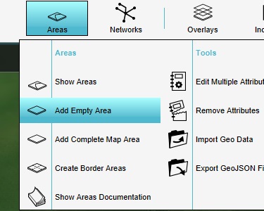

Add an area to the project, covering the complete project area.
Add an area for the complete map.

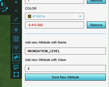

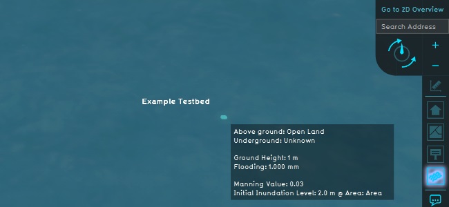

Add an INUNDATION_LEVEL attribute to the area, set to a value of 2.
This area will now cause the flooding overlay to initialize the calculation with a layer of 1 meter of water across the entire project area. (The project area's default height is 1 meter above datum, and the height of the water will be set to 2 meters above datum.)

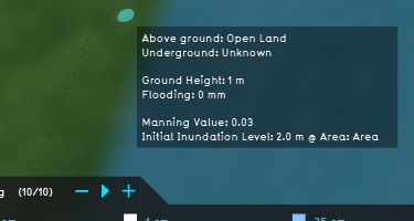

Activate the flooding overlay, and notice the entire project area is colored blue, indicating the presence of water. Click anywhere in the project area to see a "Flooding" height of 1 meter is calculated. If needed please make sure to calculate the area and overlay with the recalculate button in the upper left corner.

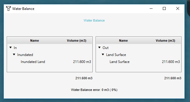

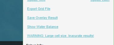

Select the flooding overlay in the editor, and select the "Show Water Balance" option.
Open the water balance.
The water balance opens. This window shows the amount of water in the project area, according to the flooding overlay's calculation.
The water balance.
A project area of 500 meters by 500 meters has a total surface area of 250.000m². Given that the project area is covered uniformly by a layer of water of exactly 1 meter, this should result in 250.000m³ of water. However, the water balance indicates 211.600m³ of water in the project area. So there's 38.400m³ of water missing.
If you click at the edge of the project area, you will see that there is a zone where the amount of water is 0. This means that there are indeed cells where, despite covering the entire area uniformly with water, an edge of cells is excluded.
Knowing how large our project area is, and how much water is actually placed in the project area, we can calculate the amount of cells the project area is divided into, and the amount of cells which are actually used.
To calculate the amount of cells in the project area, we can take the size of the map (500 meters by 500 meters) and divide it by the grid cell size (which is 10 meters by 10 meters, by default). This tells us the project area is divided into 50 by 50 = 250 cells.
To calculate the amount of cells actually used in the project area, we work backward from the amount of water in the project. There is 211.600m³ of water, which means an area of 211.600m² is actually being calculated. Taking the square root of 211.600m², we get an active project area of 460 meters by 460 meters. This means 46 by 46 cells.
From this, we can conclude that the outer 2 cells are disregarded when performing the flooding overlay's calculations. (Along the horizontal axis, 2 cells on the west side and 2 cells on the east side are not used, and along the vertical axis 2 cells on the north side and 2 cells on the south side are not used.)

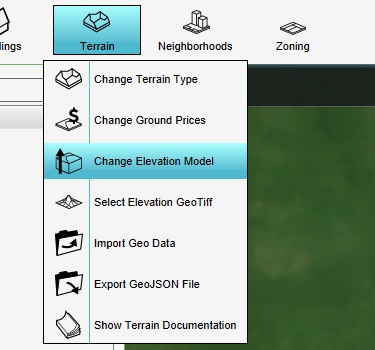

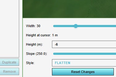

Open the terrain's change elevation tool. You will use this to change the height of the terrain to create the necessary setup.
This will open the terrain elevation brush panel in the bottom of the editor. For simple setup, we will create 2 indentations in the terrain, directly attached to one another and one deeper than the other.

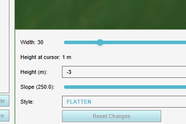

Configure the brush as follows (approximately):
  • Width: 30 (meter)
  • Height: -3 (meter)
  • Slope: 250
  • Style: Flatten

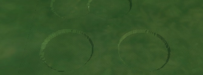

This will create a hole, with a radius of 30 meters, and a depth of 4 meters. (The project area's default height is 1 meter above datum, and the specified setting will place the bottom of the hole at 3 meters below datum, so the total depth will be 4 meters)
Settings for the first manipulation of the terrain.

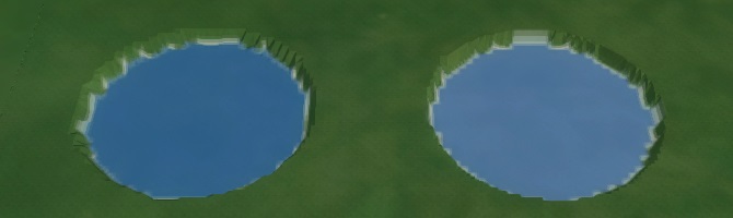

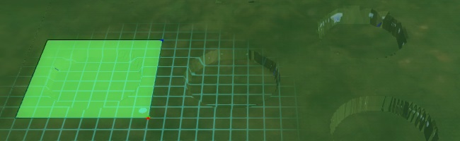

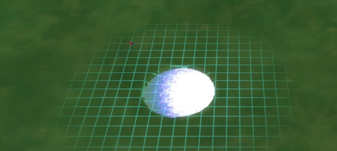

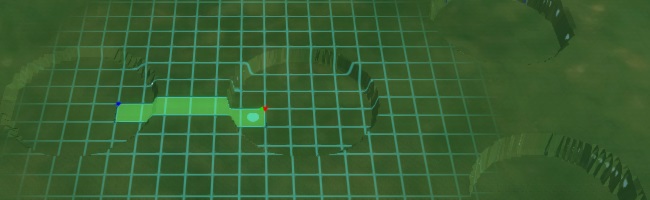

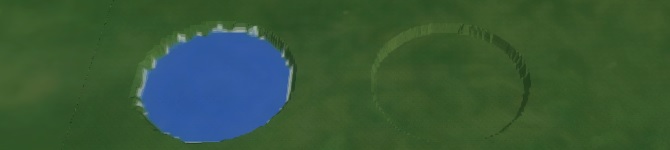

In the 3D Visualization, click anywhere in the project area, such that the entire hole is inside the project area. (If you are having trouble determining where the edge of your project area is, try placing a construction in the corner of the project first, as a navigational aid. Adding a construction will not affect the model we are setting up.)
The first manipulation of the terrain.
Note that the hole created may appear to be filled with water. This is because the selection made is not permanent yet. As a result, the water visualization has not been updated yet, and may appear whenever a selection which lowers terrain is made.
If the created selection is as desired, please feel free to apply selection before you start drawing a new selection. Take into account that there is no undo option so the applied selection is permanent. Next, change the "height" setting of the brush to -6.
Change the height setting.

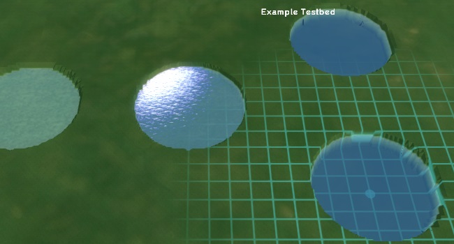

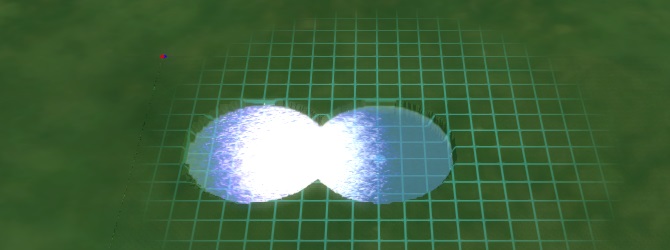

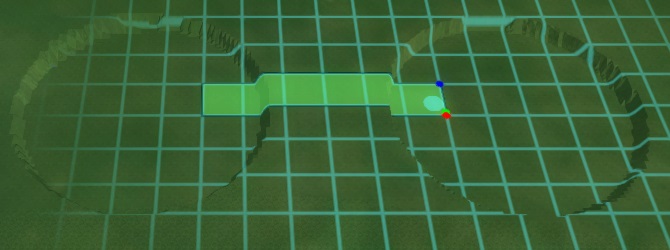

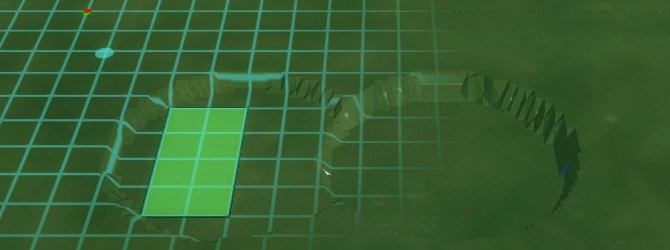

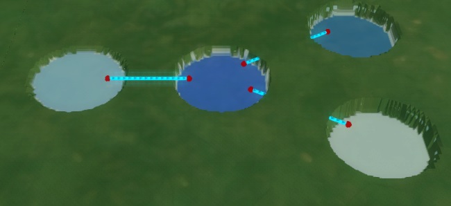

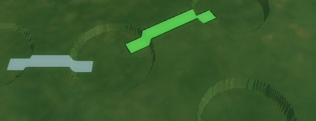

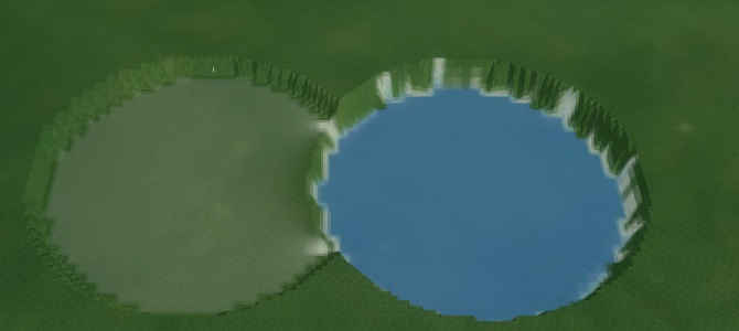

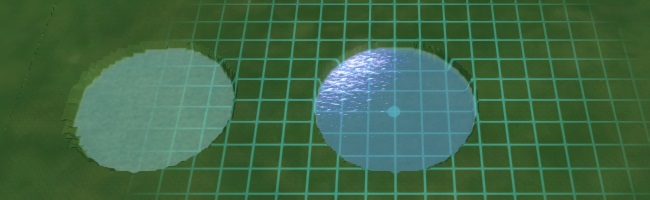

Now place another hole in the project area, such that the first hole and the second hole are connected.
The two holes overlap.

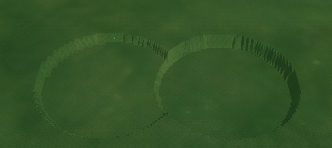

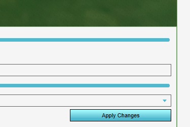

Finally, click "Apply Changes" to complete the adjustment of the terrain height.
The selection so far is a preview of the manipulation you wish to make. When you click "Apply", the changes are actually made.
Now that the heightmap is changed, you will be able to properly see the created holes.
When the actual change is applied, the water visualization is redetermined as well, showing the actual terrain height.
Now we have a basic height difference. The reason for creating 2 pits instead of 1, is to make sure that water which is used in this test remains in this test, and does not flow of into other places. If water is allowed to flow away, then at least its not possible to account for all the water in the end result, and at worst the water may affect other tests.

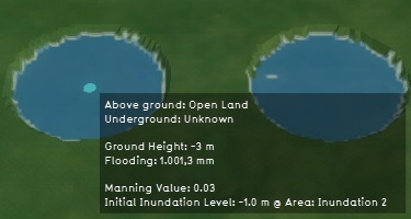

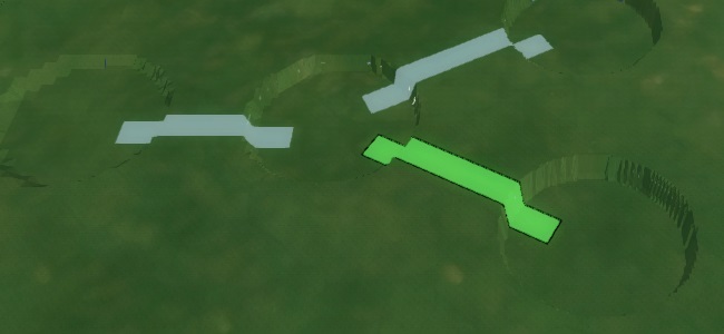

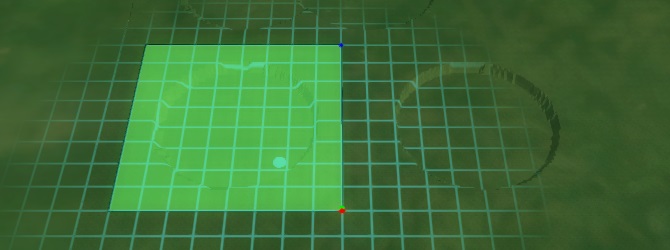

Add an area to the project. Set the name of the area to "Inundation 1".
Draw the area in the project area. Specifically, make sure it sits inside the higher of the 2 hole, with no edges on the normal surface.
The location where the area is drawn will be filled with a column of water.

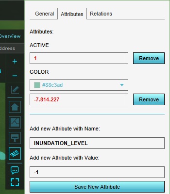

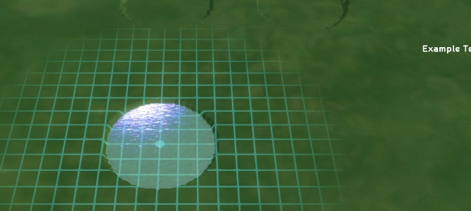

Add the attribute "INUNDATION_LEVEL" to the area, with a value of "-1". In the context of the flooding overlay, this means this area has a column of water up to the height of -1 meter relative to datum. The bottom of the hole being at -3 meters relative to datum, the column of water will be 2 meters high, but still 2 meters below the surface of the rest of the terrain.
The INUNDATION_LEVEL attribute will be interpreted by the flooding overlay as an initial deposit of water.
Looking at the current result of the calculation of the flooding overlay, it's clear that the results are rather crude. Therefore the results on your screen can differ from the image you so in this tutorial. By changing the grid size the results will probably corresponde better accordingly to this image.

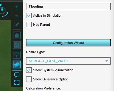

Currently, the result type is WATER_STRESS, which shows the highest amounts of water which existed in a cell at any point during the overlay's calculation. Set the result type to SURFACE_LAST_VALUE, which shows the exact amount of water present in any cell at any given point in the calculation.
Change the result type to SURFACE_LAST_VALUE to get a more intuitive output.

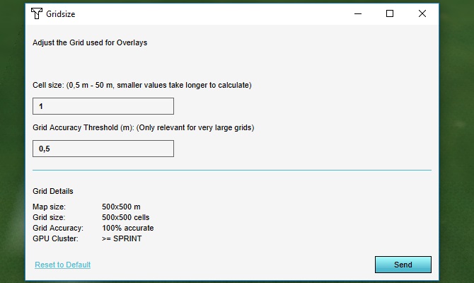

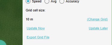

Next, select "Change Grid".
The "Change Grid" option allows changing the accuracy of the calculation and its results.
Change the grid cell size settings as follows:
  • Cell size: 1 meter
  • Grid accuracy threshold: 0.5 meter
This will greatly increase the accuracy of the calculation. Due to the simplicity of the model, the calculation times will still be extremely low.
Set the grid parameters to lower values to increase their accuracy.

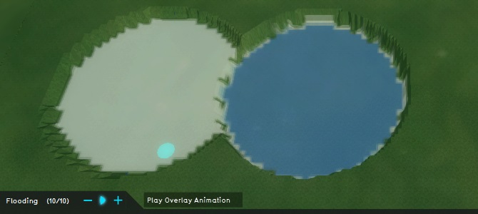

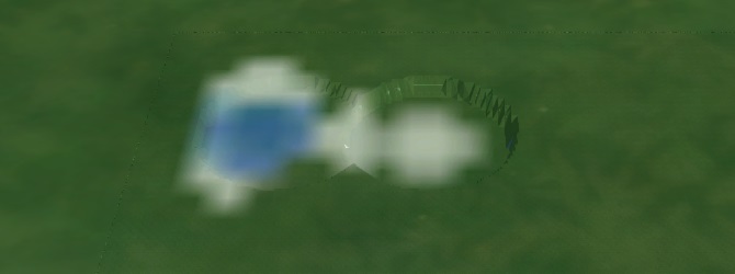

Click "Send". After the overlay has recalculated, you will see the end result of the flooding calculation has changed.
The results are more accurate now

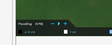

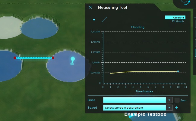

Use the timeframe controls in the overlay's legend to switch to the first timeframe.
The timeframe controls of the overlay can be used to switch between various snapshots made during the calculation.
What you'll notice specifically is that the calculation's results is composed of 10 timeframes. Each of the timeframes represents a snapshot of the process of water flowing into the deeper hole. However, the water flows so quickly that even at the first timeframe most water has already flowed into the lower hole. This means the timescale of the simulation should be tweaked as well.

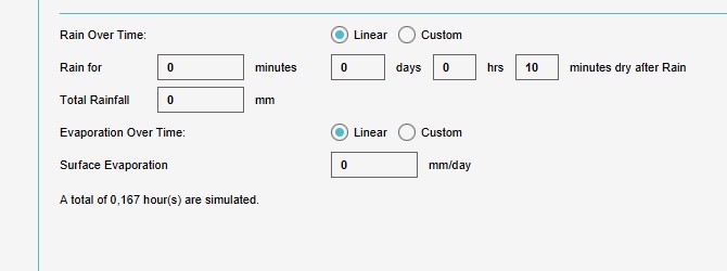

Select the overlay in the editor, and open the configuration wizard.
The configuration wizard allows for easily configuring a number of parameters for the calculations.
Click "Next" to continue to the weather configuration step. In this step, set the following configuration:
  • Rain for 0 minutes
  • Total rainfall 0 mm
  • 0 days, 0 hours, 10 minutes dry after rain
  • Surface evaporation of 0 mm/day
Rainfall, simulation time, and evaporation rate. Each of these properties have default values which can and should be tweaked to have better control over what happens during the calculation.
Close the configuration wizard, and click "Update Now" to force the overlay to recalculate.
Now using the timeframe controls, its possible to see how the water moves into the lower hole over time.

Open the terrain elevation tool again. Configure the brush as follows:
  • Width: 30 (meter)
  • Slope: 250
  • Style: Flatten
Next, pick a new location for another setup, without it overlapping with the first setup. Click in the 3D Visualization to create a new hole. Create another hole next to it, in such a way that there is still some room between them. Both holes should now be identical.
The two created holes are separate from the first setup, and are separate from one another.
Add another area to the project, and name it "Inundation 2". Draw it in so it completely covers one of the newly created holes.
The entire hole will be filled with water. Water will not be placed on the default land, as the height of the water will be set to be below the height of the terrain.
Add the attribute "INUNDATION_LEVEL" attribute to the area, and set the value to -1.
Set the INUNDATION_LEVEL attribute.
Now when the overlay is recalculated, the results will show the hole is now filled with water, without having flowed into the other hole.
One of the holes is filled with water.
It is certain that the terrain elevation does not allow water to flow from one hole to another. This is good, because that means that when a culvert is added, it is the only way via which water can flow. The results will therefor be entirely dictated by the culvert's flow.

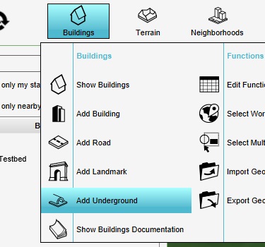

Add an underground construction to the project.
Add an underground construction.

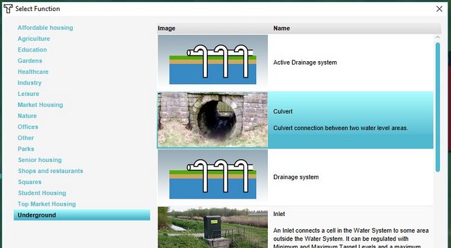

Select the construction. Click on the "Change Function" button to open the function selection window.
Click on "Change Function" to change the function of the construction.
Select the "Culvert" function, and then click "Apply".
Find and select the "Culvert" function.

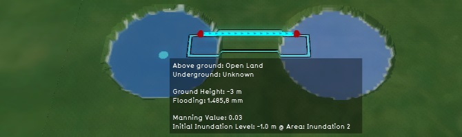

Draw the culvert into the project area, such that each end is inside one of the holes.
Make sure each end is at least one full block inside the hole.
When the culvert is added to the project, and the overlay is recalculated, the effect of the presence of a culvert is already apparent, with water having flowed into the other hole.
The second hole now also contains water.

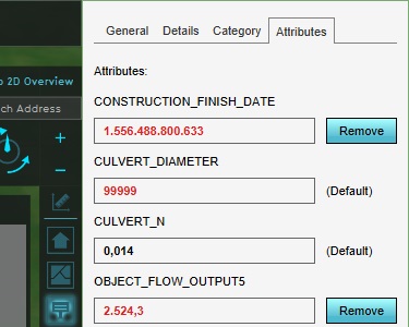

Since the only aspect of interest for this setup is the height at which the culvert exists, it's necessary to rule out the limiting effect culverts would have on throughput. Switch to the culvert's "Attributes" tab, and change the "CULVERT_DIAMETER" attribute to 99999.
By increasing the diameter of the culvert, the effect of limited throughput through the culvert is disregarded.
After the overlay recalculates, you can click in either hole and see the calculated water level. Both water columns should be around the same height, to within a few centimeters of margin.
Clicking in either hole will show comparable values.

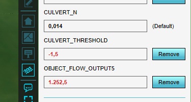

Now, the height of the culvert can be configured. Add the attribute "CULVERT_THRESHOLD" attribute to the culvert, with the value "-1,5".
The "CULVERT_THRESHOLD" attribute effectively sets the height at which the culvert resides.
The result now is that water flows from one hole to another, via a culvert at a height of -1.5 meters relative to datum. The height of the water starts at -1 meters relative to datum. Water flows through the culvert, lowering the height of the water, until the water level passes the bottom of the culvert. From that point onward, water can no longer flow through the culvert, and thus the water level stops decreasing.

Now using the timeframe controls, its possible to see how the water moves into the lower hole over time. Most notably, that the flow of water explicitly stops when the water level gets below the height of the culvert.
This setup demonstrates that water will flow from a location with a higher water level to a location with a lower water level, if there is a path the water can take. If a construction allows water to flow through and the water level is high enough to reach it, water can and will flow through. When that is no longer true, the flow of water stops.

Place the first hole for this setup, not too close to the existing setups because this setup will require a tiny bit more space.
Change the "height" setting of the brush to -6, and place another hole next to the first hole, such that they are not directly connected. This will be the main water basin.
Place the second hole near the first hole.
Change the "height" setting of the brush to -10, and place 2 more holes next to the second hole. These will be the outflow basins.
Two additional holes.
Finally, if you haven't done so yet, apply the selection so the holes are created.

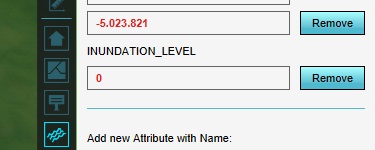

Add the attribute "INUNDATION_LEVEL" attribute to the area, and set the value to 0.
This will fill the hole with a water column with a height of 3 meters.

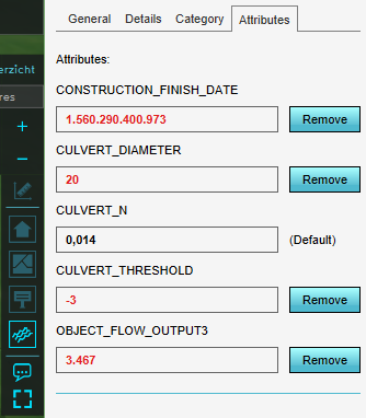

Set the following attributes for the culvert:
  • CULVERT_THRESHOLD: -3
  • CULVERT_DIAMETER: 20
Leave the other attributes as they are.
The attributes for the culvert.
Add a culvert to the project area, connecting the second hole to one of the last 2 holes; a connection between the main water basin and an outflow basin. Give the culvert the following attributes:
  • CULVERT_THRESHOLD: -5
  • CULVERT_DIAMETER: 1
The second culvert. If it's necessary to draw the culverts at an angle, you can use the "Line" draw mode.
Add a culvert to the project area, connecting the second hole to the other of the last 2 holes; a connection between the main water basin and the remaining outflow basin. Give the culvert the following attributes:
  • CULVERT_THRESHOLD: -4
  • CULVERT_DIAMETER: 6
The last culvert.
This setup will mean that water flows into the main water basin. Some water will flow into the first outflow basin, but its culvert does not have sufficient capacity to drain water from the main water basin as fast as it is being filled. At a certain point the water level in the main water basin is so high that water begins to flow into the second outflow basin. When the flow into the main water basin tapers off, flow into the second outflow basin should stop as well, leaving only the first outflow basin to be slowly filled with the remaining water.

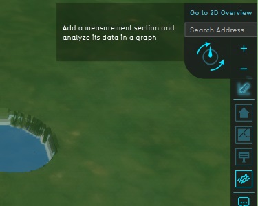

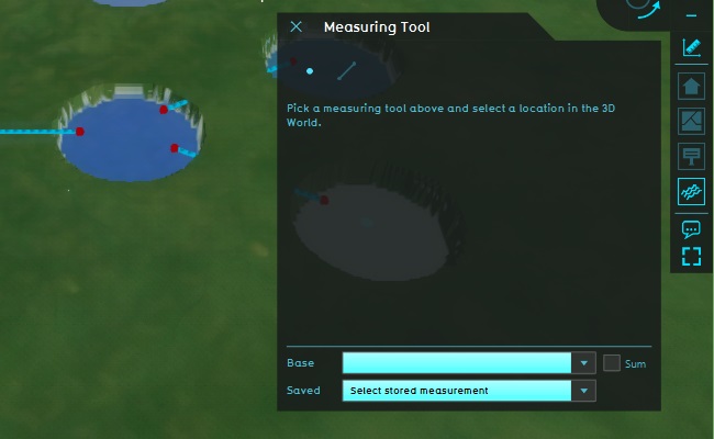

In the overlay menu, select the measuring tool icon. It is located directly above the overlay icons, and directly below the camera controls.
Click the measuring icon to open the measuring tool.
The measuring tool now opens. This tool allows measurement points to be placed in the 3D Visualization. These measurement points give insight into the results of calculated overlays.
The measuring tool.
With the measuring tool open, and with the flooding overlay active, click in any of the basins with water to place a measuring point. This will show a graph of how much water is calculated to be in that basin at any given point during the calculation.
Results of a measuring point.
The measuring tool works on any calculated overlay, so the magnitudes and units of the values displayed are dependent on the selected overlay. In the case of the flooding overlay used here, it displays the height of the water column in meters, relative to the surface of the terrain.
Using the tool, it's possible to inspect more closely what happens in the flow network. Place the measuring point in the main water basin of the flow network.
Height of the water column in the flow network setup.
This will show that over time, water will flow into the water basin. But the water levels off at a certain point, indicating that the inflow and outflow are in balance. This continues up to a certain point, where the water level begins to lower, meaning the inflow is decreasing, while outflow continues.
