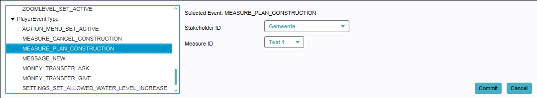

In general, adding Events to an element in the Tygron Platform happens on the right panel, after selecting the element (ex. measures, scenario, etc) to have an event added to on the left panel first. Select on the right panel bottom the 'Add Event' button; a default blank event named NO_DEF is created in the list above the buttons. Selecting an Event on the list and using the 'Remove Event' button deletes the event from the list.
Selecting an event on the right panel also opens up the bottom panel where the actual event type can be selected. This selection can then be confirmed on the bottom panel by using the 'Commit' button. The 'Cancel' button clears the selection on the bottom panel.
Event bundle bottom panel with 'Commit' and 'Cancel' buttons

Changing the properties of a Server Side Event in a project
The properties of events can be edited on the bottom panel (see image above). On this panel a linked ID of a measure or cinematic can be linked to an event for instance. Also can a dedicated stakeholder be selected here for Participant Type Events. Again, any changed made need to be confirmed first with the 'Commit' button, or cancelled with the 'Cancel' button.
