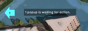

A popup arrow panel on the left side of the screen, indicating that a popup requires attention.
