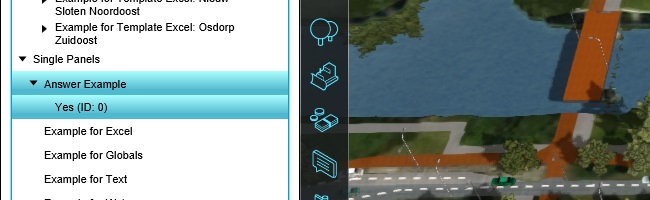

While the “Answer Example” panel is selected, click “Add Answer” at the bottom of the right panel.
Change the name of the answer to “Yes”.
An answer added to the panel, and renamed to "Yes".

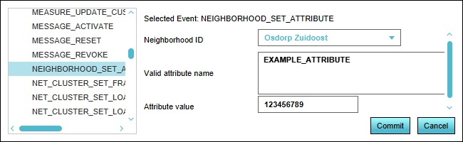

Select the “Yes” answer in the left panel. In the right panel, click on “Add Server Event”. A new “NO_DEF” event will be created. Select it.
The "NO_DEF" event has been added.
At the bottom of the editor, a panel will appear where a specific event can be selected.
Select the event “NEIGHBORHOOD_SET_ATTRIBUTE”.
Select one of your neighborhoods. Remember which neighborhood will be adjusted.
Enter as attribute name “EXAMPLE_ATTRIBUTE”.
Enter as value “123456789”.
The values for the event have been entered.
Click on “Commit” to save these properties for the event.
