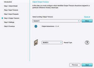

An output tensor link in the Inference Overlay Wizard.

  • The inference overlay wizard will report an issue when a result type is referenced by a tensor link and it is not yet add to the Inference Overlay.
