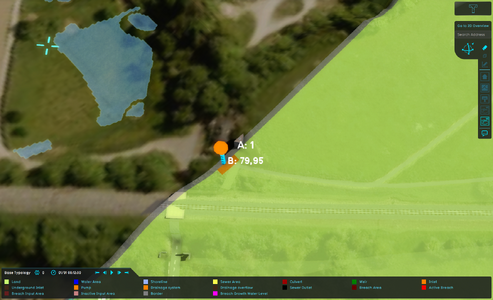

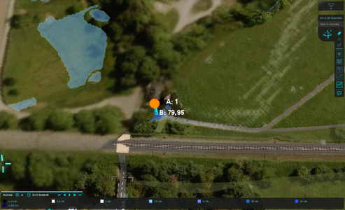

Two situations on the edge of a project are described;

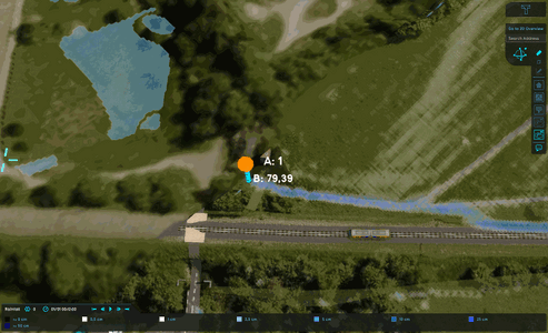

Removing water on land edge of project
Configuration
Rain: 60 minutes, 30 mm , 2 hours dry. Outlet:
  • Inlet Q: -10000 m3/s; Draining the cell(s) every timestep.
  • INLET_AREA: Either 0 (as center point) or 1 (as area)
  • UPPER_THRESHOLD: Upper threshold is optional. When the cell(s) should be drained completely, this value can be omitted.

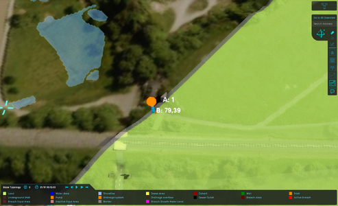

Placement

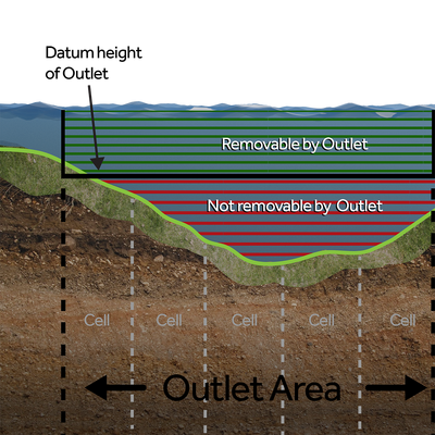

An Outlet is placed as a point by default, but can be placed as an area. On sloped terrain, this can be an issue.
The reason why water remains is because when an Outlet, is because hydraulic structures configured as an area require an area datum height. The height selected currently is the highest datum values of the cells. This is clarified in the image below: Outlet as an area on a slope. The highest cell datum point within the area is used as the bottom of the outlet area.
Surface Water removal on a slope
As can be seen below, water is removed by an outlet in both situations. For the drainage speed of the sloped terrain, both situations are quite similar. However, in the case of an Outlet as an area, water remains at the lowest point.

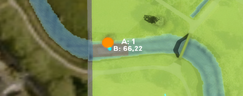

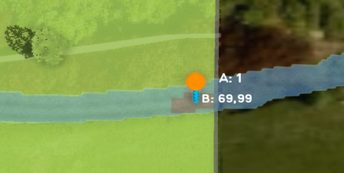

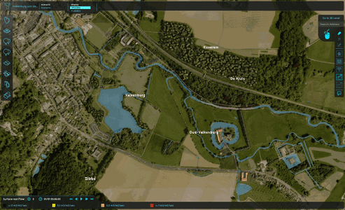

River controlled by in- and outlet
In this situation water flow in a river is controlled using two inlets; One that adds water and one that removes the water (as an outlet).
Configuration
Inlet:
Outlet:
Placement
Inlet and Outlet are placed in the middle of the stream of the river, not on the edges of the river.
