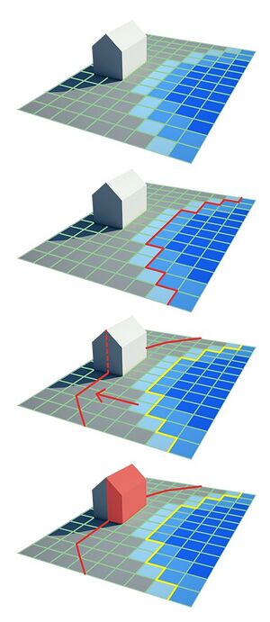

The red line shows the buffer around the selection polygon (yellow) for a LOTSIZE query based on a grid.
The BUFFER clause affects the polygon selection of the TQL query. When a query makes a selection for, for example, LOTSIZE, the clauses indicate in which selection polygon you want to find the lotsize. The selection polygon is computed by the overlap of clauses such as AREA and MINGRIDVALUE. After this selection polygon is computed, it is queried to find all the relevant lotsizes within.
The buffer is applied after computing the selection polygon, but before finding the lotsize inside the selection polygon. The selection polygon is buffered with the indicated amount to create a larger selection polygon, in which more lotsize may be found.

Buffers can also be used in combination with grids to conditionally write data to buildings. For example, consider a use-case where buildings with water nearby should be marked as "threatened".
To find buildings with water on them:
SELECT_LOTSIZE_WHERE_GRID_IS_4_AND_MINGRIDVALUE_IS_0.1*
(*Assuming grid 4 is a Water Overlay's SURFACE_LAST_VALUE result type, and the relevant amount of water is 10cm)
How to write an attribute (THREATENED) to buildings with water on them:
UPDATE_BUILDING_THREATENED_WHERE_GRID_IS_4_AND_MINGRIDVALUE_IS_0.1
How to update buildings with water not just on them, but also within 1 meter of the water:
UPDATE_BUILDING_THREATENED_WHERE_GRID_IS_4_AND_MINGRIDVALUE_IS_0.1_AND_BUFFER_IS_1

  • Buffers only apply to selection polygons. This includes specific polygons, attribute polygons, and grids, but not individual buildings.
  • When a buffer clause is used to extend a selection polygon, the new selection polygon includes both the original selection polygon as well as the buffer around it.
  • When buffering based on grids, take into account the grid size in respect to the buffer size. If the buffer size is not greater than the grid cell size some vector-based data such as buildings may be less likely to be in range of the grid-based data.
  • Buffers cannot be negative. It is not possible to shrink a selection polygon.
  • When using a BUFFER clause to create a selection polygon, it is not possible to automatically create an inverse selection. I.e. for a query looking for grid values higher than a certain value and a query looking for grid values lower than that same value, the selection polygons are effective complementary. However, when the queries are buffered, the two selection polygons will overlap.
