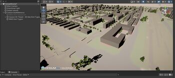

Data from a Tygron Session visualized in Unity.
Depending on use-cases or the intended audiences for the results of calculations in the Tygron Platform, it may be desirable to have external tooling or applications read data from a running Session for visualization. One environment which forms a powerful framework for a variety of use-cases is Unity. Using the Cesium plugin for Unity, it is possible to directly connect to a Session and obtain visualization data from it, so that it can be viewed as a complete 3D world in Unity.

  11. Double-click on "Tygron 3D Tileset" to move the camera to the 3D Tiles loaded from the Session.
  12. Select the "Cesium Georeference", and click on Place Origin Here.
