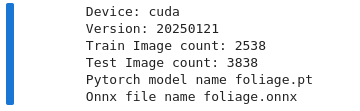

to the folders containing the exported datasets. See how to export AI datasets for more information. - Press the double arrow button named Restart kernel and execute all cells to run the Jupyter Notebook. See the images below of what to expect.

- In the step with the Configuration of the example_config notebook, cuda should be printed. If not, cpu will be printed. Training a model on your cpu is significantly slower. You might need to open the command line tool on your computer and run the command nvidia-smi to find out what version of cuda is supported on your gpu.
