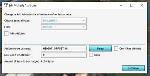

Editor → Current Situation (Ribbon tab) → Buildings (Ribbon bar) → Edit multiple attributes (Dropdown)
How to remove the height impacts of all bridges in a Project:
  1. Open the "Edit multiple attributes" screen.
  2. Set the filter to "BRIDGE"
  3. Set the attribute to change to "HEIGHT_OFFSET_M"
  4. Set the target height to 0
  5. Click "Set value". All bridges now have their height impacts removed.
