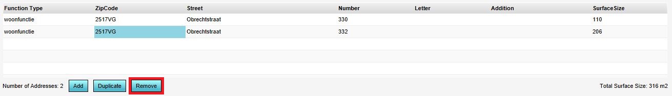

How to remove an address
Editor → Current Situation (Ribbon tab) → Buildings (Ribbon bar)
How to add an attribute:
  1. Select the building where you want to remove an address.
  2. Go to the bottom panel.
  3. Select the address you want to remove
  4. Select the Remove button
  5. A warning pops up and after selecting yes the address will be removed (Note: this action cannot be undone)
Removing an address
