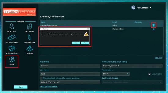

User menu panel.
Main Menu → Options → Users
How to remove a user:
  1. Select "Options" in the main menu
  2. Select "Users" in the Options menu
  3. Click the "garbage can" button
  4. Confirm (or decline) the pop up panel
When you delete a user, keep in mind that all projects within the domain that this person owns are not automatically deleted and ar not accessible, except when the project-rights are set so that the project is accessible to all users in the domain. If not, only the Domain Admin can switch project ownership so the project is accessible again.
