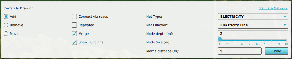

Net edit is an option in the editor that allows users to add, remove or replace Net Lines for networks using special drawing tools. These drawing tools are different from the usual selection drawing tools (brush).
The Net Edit panel

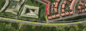

  • Remove
    • Select a net line to remove, highlighted in red. With the option repeated selected, more net lines will removed until a net node is encountered that is connected to more than one other net line.

Draw options
There are some additional draw options for editing networks.
Connect via roads
This option is used when in the Add draw mode. It will add multiple Net Lines following the road to connect the start and end point when adding Net Nodes.
Repeated
This option is used when removing Net Lines or Net Nodes. The original Net item will always be removed, but additional Net Nodes can be removed as well, as long as those Net Nodes are only connected to one Net Line.
Merge
Whether or not added Net Nodes should be merged with existing Net Nodes and Net Lines. You can adjust the merge distance using the corresponding value field.
Show Buildings
This option simply lets you turn off the visualization of Buildings in the 3D Visualization.
Node Depth
It is possible to adjust the depth at which the Net Nodes will be added.
