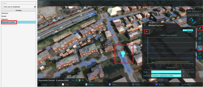

How to make a point measurement
How to make a point measurement:
- Select any Grid overlay in the overlay menu.
- Select the measuring tool icon (signified by a ruler) in the overlay menu, located between the zoom buttons and the overlay icons.
- Select the Point Measurement option (signified by a point) at the top of the measuring tool window.
- Click on the location in the 3D Visualization where a measurement is desired.
- The graph in the measuring tool window now displays the value at location.
Making a point measurement in a Rainfall overlay's grid.
- If it's a Grid overlay with timeframe functionality, such as the Water, Heatstress and Subsidence Overlay, the graph displays the value at that location over time.
- In case a Water Overlay is selected and a visualized water object is selected for the location, an object measurement will be created instead of a point measurement.
