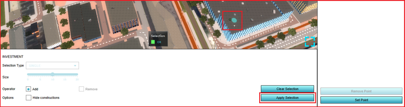

Remove Point
With the remove point option you can remove the visual global from the 3D Visualization. The global is still present in the project, as you can see in the right panel.
Set Point
With the set point option you can let a global be displayed at a specific point in the 3D Visualization. You can attach the global to a specific place regardless of whether there is a building. More information about how to draw a point in the 3D Visualization is explained on the brush panel page.
