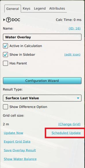

An update can be schedule by clicking on the Schedule Update link.

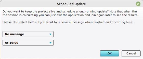

How to postpone grid overlay recalculation:
  1. Select any grid overlay in the editor.
  2. On the right panel, select "Schedule Update".
  3. A Schedule Update panel will open
  4. Select in what way you want to receive a message once the calculation is complete.
  5. Select at what time you want to the calculations to commence.
  6. Click on OK to Schedule the update.
The Schedule Update link has changed to the date at which it will be updated.
