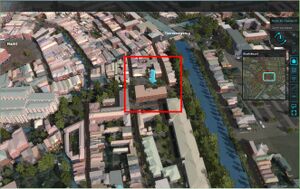

1 Have a project loaded in the editor and decide the area of interest of the Travel Distance overlay, a school in our case.
School selected as example, the blue arrow is added for clarity

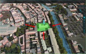

2 Add an area and select to Adjust the area. Draw in the area around the school. Important: Ensure that the area overlaps the adjacent roads. In our example the area overlaps with roads east, west and south of the school. Apply the selection.
Please note that the area overlaps all adjacent roads east, west and south of the school
