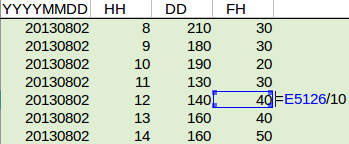

How to calculate the hourly wind speed
The hourly wind speed from the KNMI weather data table column FH has to be divided by 10, since it is defined in 0.1 m/s.

| 5/E | FH | 0.1 m/s | Uurgemiddelde windsnelheid (in 0.1 m/s). Zie http://www.knmi.nl/kennis-en-datacentrum/achtergrond/klimatologische-brochures-en-boeken |
- The values at each hour regard the measurement over the preceding hour up to that time. To obtain the value for 12:00 UTC, the values at 12:00 UTC must be used.
