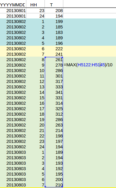

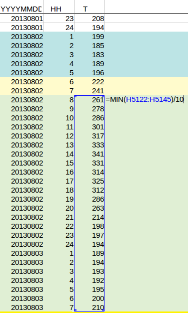

How to calculate the daily min and max temperature
The daily average min and max temperature has to be measured from 8 UTC current day to 7 UTC the next day, according to the DPRA Heat stress report. The temperatures are also measured in 0.1 °C, so the values from the KNMI weather data column T have to be divided by 10 to get to values in °C.
| Column | Name | Unit | Dutch Description |
| 2/B | YYYYMMDD | Date | datum (YYYY=jaar,MM=maand,DD=dag) |
| 3/C | HH | Hour | tijd (HH=uur, UT.12 UT=13 MET, 14 MEZT. Uurvak 05 loopt van 04.00 UT tot 5.00 UT |
| 8/H | T | 0.1 °C | Temperatuur (in 0.1 graden Celsius) op 1.50 m hoogte tijdens de waarneming |
- The values at each hour regard the measurement over the preceding hour up to that time. To obtain the value for august 2nd, the values at 8:00 UTC of august 2nd, up to and including 7:00 UTC on august 3rd must be used.
