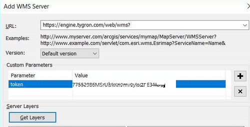

For the steps on how to add the Tygron Platform WMS URL ArcMap, please see 'Adding WMS services', which is part of the ArcMap documentation,
http://desktop.arcgis.com/en/arcmap/10.3/map/web-maps-and-services/adding-wms-services.htm
Notice that you only have to add as WMS URL the beginning of the URL, excluding the token. The URL becomes then: "https://engine.tygron.com/web/wms"
Then, add a custom parameter with the name token and as value the actual value of the token.
Add the Tygron Platform WMS to ArcMap
