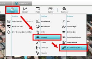

| 1 | From the Current Situation tab, add a Travel Distance Overlay from the category Distance. Adjust the grid as desired, 1 meter will give a nice resolution in our example. | |

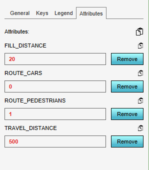

| 2 | Go to the Attributes tab of the Travel Distace Overlay. The Fill distance is set by default on 20m and the Travel distance on 500. Set the Route cars on 0 to not inculde roads for car traffic. Set the Route pedestrians on 1 to include roads for pedestrian traffic. | |

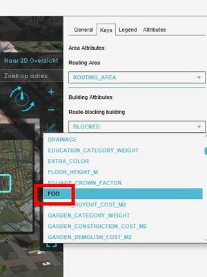

| 3 | On the Keys tab of the overlay, on the right side of the editor, the defaults keys DESTINATION_AREA and BLOCKED are already filled in. It is possible to change the key to another attribute (for example: 'FOO') can also be selected in the drop down menu for each of these keys. For this how to this is not necessary. | |
