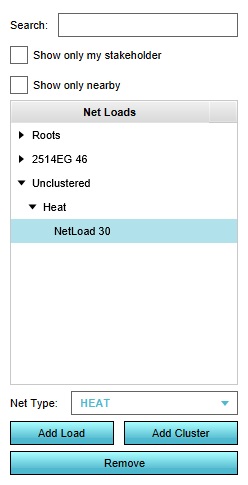

The left panel for net loads in the editor.
In the overview of net loads, all net loads are automatically displayed grouped into their net clusters, or into the groups "Roots" (for root loads) or "unclustered" (for loads which are not part of a cluster). Within these clusters, the net loads are then grouped by network type (i.e. HEAT, GAS, etc).
How to add a net load:
  1. Select the desired Net Type.
  2. Select "Add Load".
How to remove a net load:
  1. Select the cluster the net load is in (or Roots or Unclustered if the load is a root or unclustered.
  2. Select the specific net load you wish to remove.
  3. Select "Remove".
