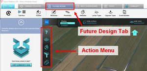

1 Click on the Future Design tab. Notice the Action Menu is now visible (vertical black bar on the left side of the Main View, below the Future Design tab). Click on the question mark icon to start a flytrough of the project. In this flytrough you will get familiar with different wind and solar functions in the Tygron Platform.

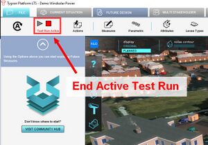

2 After the flytrough, make sure the Test Run is stopped by clicking on the red square stop button (in the top left corner in the screen) for the following steps.

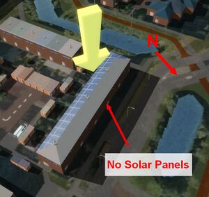

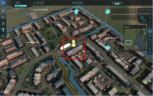

1 Navigate to the block of houses with solar panels, indicated by a yellow arrow.
2 Notice that the solar panels are not placed on the north side of the roof.

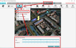

3 To adjust this Solar Panel setting, go to the Tools tab, hover over Sun angle and click on Edit roof solar position. Adjust the sliders in the Bottom panel and notice the difference in placement of the solar panels. For more information, see this article.

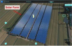

1 Navigate to the solar farm in the field, indicated by the second yellow arrow.

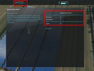

2 Click on the Solar Area Indicator on the Top bar to open the indicator panel. On this panel you can see the surface area of solar farms in hectares (on land, on water and in total) in the project area.

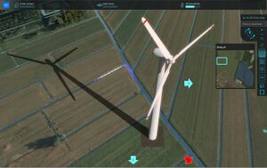

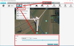

1 Navigate to the wind turbine. When you have located the turbine, you can see the shadow it casts on the surrounding area. With the Tygron Platform it is possible to see how the shadow changes throughout a day and/ or year, which is important for finding a suitable location for a wind turbine.
2 Click on the Tools tab and click on the Sun angle button. Change the date and time to see the shadow moving.

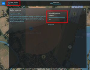

3 A wind turbine also has a certain noise contour. To see the noise contour, click on the Noise contour Overlay in the Overlay bar. Tip: the overlay is better visible if you zoom out a bit.
4 Click on the Noise contour Indicator in the Top bar to see how many houses are in this contour and may experience noise disturbance.

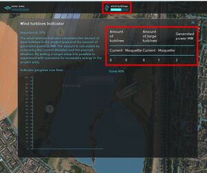

4 Click on the wind turbines Indicator in the Top bar to see how much power is generated. For more information about this indicator, see the description. Notice that a score is calculated, based on the generated power and a target. The target is set on 5 MW and is adjustable.
