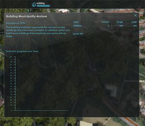

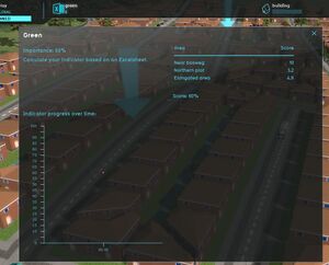

2 At the top of the the viewer interface you can see the top bar. Click on any of the Indicators to open an indicator panel with information on how a score for the Project is determined.
The Green Indicator shows whether there is a sufficient amount of publicly available green space in a given area. Depending on the aspects of that location, the ratio should be anywhere from 10% to 60% to receive a minimum allowable score of 6. The default score (and maximum score) is 10. The Housing Indicator shows whether a sufficient amount of additional constructions have been planned, specifically housing. The target is set to 260 additional houses.

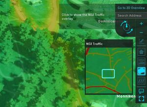

  • There is a Traffic NO2 Overlay, which automatically calculates spatially the amount of NO2 caused by traffic for any given location.

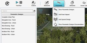

Editor → Future Design (Ribbon tab) → Parametric (Ribbon bar) → The Parametric Design to edit (Left panel)
1 Switch to the "Future design" tab, and then click on "Parametric". This will open the list of currently defined Parametric Designs in the left panel of the Editor.

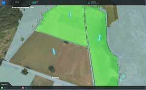

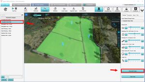

2 Select "Complete Urban Plan" in the list of designs. The area of the plan is now highlighted in green. Select 'Generate Design' on the bottom right to continue.
Area of a Parametric Design selected in the 3D Visualization.

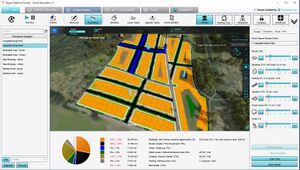

3 In the 3D Visualization a colored representation of the planned design now appears. Sliders with details about this design are now available on the right panel of the editor display .
Take note of the following:
  • You will see the main structures are lined up along the pre-existing and the newly planned roads.
  • You will see a number of bands along the roads, representing room for pavement and parking spaces.
  • You will see in the center of the various blocks small ponds.
All of the features you see are automatically generated, based on parameters of the design (hence the name).

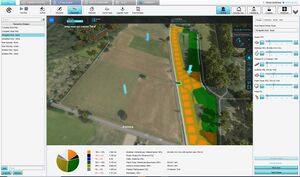

A selected Parametric Design displayed in the 3D Visualization.
4 In the bottom panel, you will also see a pie chart and a number of statistics regarding the design as it currently stands. The statistics show how much space will be taken up by each feature. It additionally shows a percentage, indicating how much of the total area of the design that represents. The pie chart is a graphical representation of those percentages. Note that the sum of the percentages (and thus the pie chart) may not add up to 100%, indicating some of the design's space is left empty.

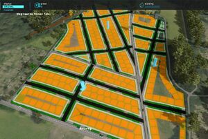

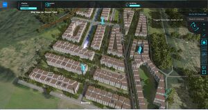

5 At the bottom of the right panel, click on "Apply Design". Note that a test run will start; that's ok. You see a large amount of structures appearing in the 3D Visualization, matching the pattern previously displayed by the colored representation.

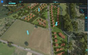

The applied Parametric Design displayed in the 3D Visualization.
6 Note that the Indicators in the top bar have changed as well. The average score for the Green Indicator has dropped from a 10 to 3. And if you click on the Indicator to see the scores per section of the planned area, you will even see that the scores for some areas have dropped even below that.

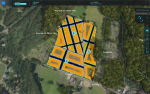

The representation of the tweaked Parametric Design in the 3D Visualization.
4 Click on "Apply Design" again, and new structures will appear in the 3D Visualization. The road layout is subtly different, and no ponds have been created. The Green Indicator in the top bar now also shows an average score of 7, which is an obvious improvement over the previous design's score of 6. Click on it, and you will see that some areas still score below a 6, and thus are not up to scratch, but a step has been made in the right direction, compared to the original plan.

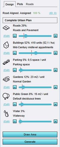

3 Select the newly created design and the right panel will display the properties of the new Parametric Design. A new design initially has default elements and values set. By clicking on the blue "Edit" links, you can select a new type of element for the default selection. The red lines on the sliders indicate the maximun value for a function in relation to the other functions. When you move one slider to the left, the red lines on the other sliders will move to the right, showing the space created by lowering one parameter. It is not possible to move a slider to the right of the red line. Only after lowering another parameter, can the maximum of a selected parameter be moved up.

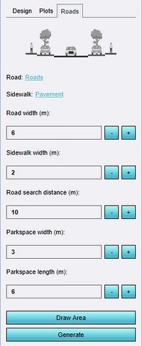

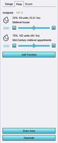

5 At the top of the right panel, switch to the "Plots" tab. This shows the list of functions defined for the various plots a Parametric Design contains. By default one functions is selected as a starting point, but more can be added to fit the project with the "Add Function" button. You can see this in effect in the 'Mixed' plans that are available for all areas.
6 Switch to the "Road" tab, and click on the blue "Roads" link to open the Function selection window. Here you can select which Function you would like to use as a road in your parametric Design. You can also select a different function type for the sidewalk. The entry fields let you adjust the width and other related values of the road, sidewalk and adjacent parking spaces. These settings all impact the amount and placement of the road function. Feel free to experiment with these.

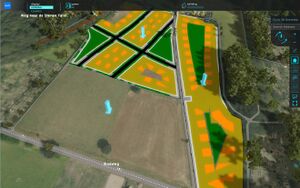

The new Parametric Design with plots and roads.

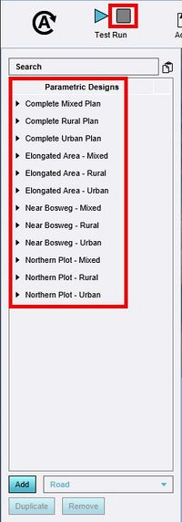

List of available parametric design plans on left panel.
2 Take note of the full list of Parametric Designs. There are an Urban and a Rural design for each of the areas. Because not all areas have the same target for the green ratio, diffent parameters are appropriate for the different areas. The area near the Bosweg has a target green ratio of just 20%, so the urban design is sufficient for that location. However, for the other areas the rural designs are more appropriate.

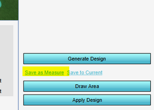

1 Note that you can also save your created parametric design as a measure. Your test run cannot be active for this. After saving the design as a measure, you can apply it during a test run. You can also choose to click on Save to Current to construct the Design in the Current Situation, however please note this cannot be easily reversed.
Click on Save as Measure
