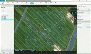

Demo Iteration Project
This section describes a technical aspect, and is mainly for advanced users.
An overview of Demo Iteration.
The Demo Iteration project is available for all users and can be found in the main menu under Edit projects. This project does not count towards your license.
This project is intended for hydrologists and other water experts.
This project showcases the rainfall overlay in a iteration mode.
The demo show the iteration functionality that can be used to adjust the ground infiltration speed using a combo formula.
Calculations using the Iteration option
The demo project simulates a Dutch polder to demonstrate how rainfall infiltration can be modeled using the iteration option.
