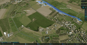

The demo project show a Flooding Overlay that simulates a river flooding over-topping a levee using multiple inlets.
The river level increases first and decreases later over time. It is modeled using several Inlets placed in front of a small levee in the elevation.
  • Note that the inlet is placed in front (at a distance) of the levee with respect to the river, instead of on top of the levee.
  • Inlet first increases the lower threshold to simulate a rising water level. After a few days, the rising stops after 250000 seconds and the lower threshold is set to -10000 (NO_DATA). Furthermore, an upper threshold is used to simulate a lowering water level. This upper thresholds starts with -10000 (NO_DATA) and only activates after 250001 seconds.
