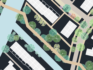

In the drawing below you see an example of a wrong draw order. The road can be seen above the trees. The Tygron Platform will load this road after loading the trees, which can cause trees to fall away. A simple solution is to sort the path backwards in AutoCAD.
Example of wrong drawing order
