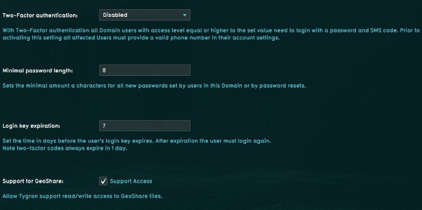

Managing the Security Policy for a Domain
Within a domain it is possible for the Domain Admin to set up specific Security Options (access via the startup Options menu).
Security Options, available under Options in the Main Menu (Domain Admins only)
Two-Factor Verification
It is possible to enable Two-Factor Verification, where users are requested to enter a secondary Security Code at login, which will be sent automatically by text message to the phone number of the user that wants to log in. I.E. this setting is enabled for the selected account type and up. If it is enabled for the Editor Account type, the verification is also required for the Domain Admin account. Please note that entering phone numbers for users is required for this option.
Minimal Password Length
This option lets the Domain Admin select the minimal number of characters required for a user password set by the user, or by password resets.
Login key expiration
This option lets the Domain Admin select how long a user can remain logged in before they need to re-enter their password.
Support for GeoShare
This option gives access Tygron support employees to edit files on the GeoShare. It is disabled by default.
